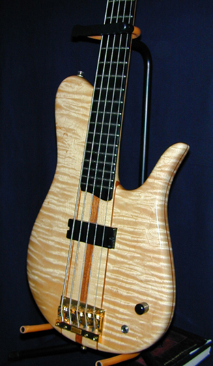

kinda looks like this one a friend and I built in the early 90's .. ripped off a Fodera Anthony Kackson model
